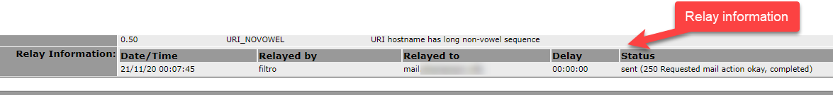

This is a message with correct relay info updated after a few minutes when the email has been delivered:
relay information.png (16.39 KiB) Viewed 6649 times

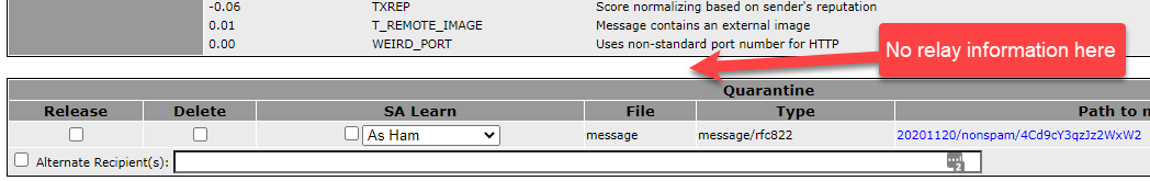

This is another message without relay information that is never updated (message has been delivered correctly):
no relay information.png (22.25 KiB) Viewed 6649 times

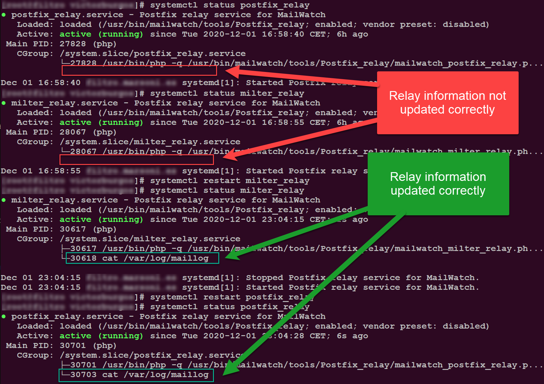

I have been monitoring this issue for a few days and this is what I have found:
Unexpectedly, all relay information stops updating on all messages.
I then restart milter_relay and postfix_relay services and they start working again for a few hours and then relay information stops again.
I notice that there is no sub-process cat /var/log/maillog process when relay information is not updated.
How can I find out why is this sub-process stopping?
relay information problem efa.png (378.56 KiB) Viewed 6517 times
Re: Force Relay information update on mailwatch
Posted: 02 Dec 2020 21:41
That is actually supposed to happen, except the not logging part. It cat's the log until it is caught up then it is supposed to follow it from that point forward, so the cat is not longer needed.
