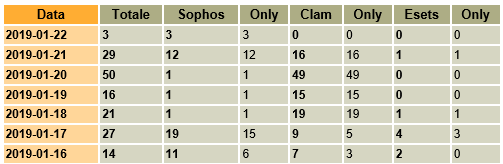

I tested these 3 supported antivirus whith these results :
We can say that we can exclude Esets also because we need to pay it
We can retain only Clam and Sophos that are free and have a good detection rate
Clamd is good because we dont use cpu using daemon
Unfortunately sophos uses 7secs of cpu 4 each message because is a standalone module
This cam be corrected using sophossavi that act as clamd and can transform Efa box into a dounble antivirus system that doesnt need cpu and that have an higher messages throughput.
