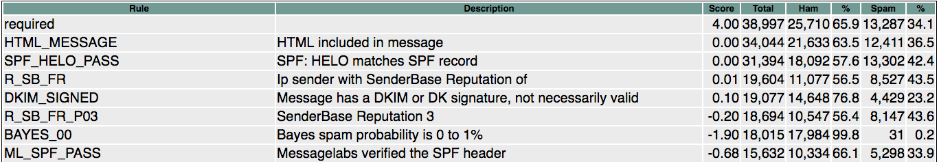

That's 7 lines added to give a report looking like:
Screen Shot 2016-08-19 at 20.18.png (110.32 KiB) Viewed 12926 times
I'll submit this as a feature request to the mailwatch project.
Note: if you change your spamassassin scoring, this report will only show you the first score it picks up from the database, rather than the current score. It is likely the score it picks up is the older one.
e.g. if I changed my BAYES_00 score from -1.9 to +37.0, the report would still show -1.9 even though new messages are scored with +37, until all the messages with that SA_RULE and score are aged out of the database.

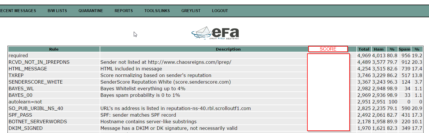

One thing, I've looked at your changed and it appears you've left out the two lines required to display the results in the html table.
Look for two single line additions at the bottom of the diff.
