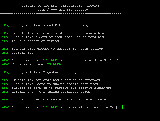

I was able to setup Dkim Signing properly:
a) On Efa Menu select 9) Spam Settings > 1) Non Spam Settings | I have Store non spam and enable Signing

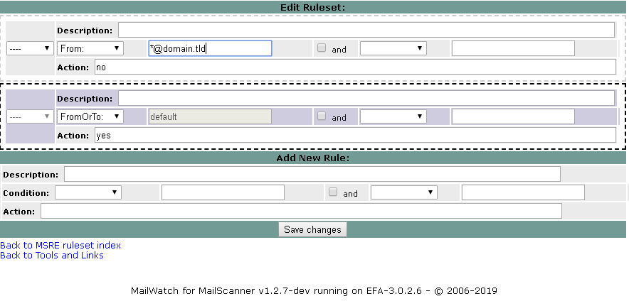

c) On the webgui choose the from domain.tld not to sign clean message
Now INBOUND messages have the signature and Outbound from the domain.tld EFA complets the DKIM Signing without body hash of email beeing Tempered with.
