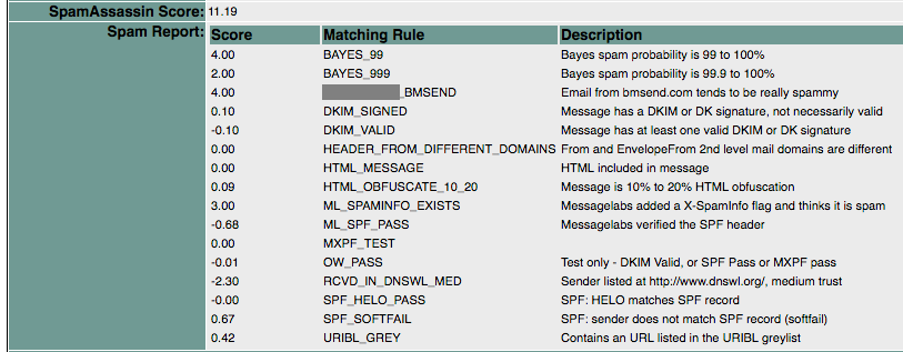

go to the efa web interface ( mailscanner/status.php or /mailscanner/rep_message_listing.php or /mailscanner/rep_message_ops.php )
find one of the messages that you are unhappy with.
on the left side as the # column and the blue circle with the letter "i" in the middle. click on it.
that brings up the message details page, scroll down until you see the lines "SpamAssassin Score" and "Spam Report". It looks like the following:
and post that information.
In the above report, my bayes filters are almost certain this is junk (3 9's). I think I also increased the weight of my bayes filter at the top end of the confidence range.
