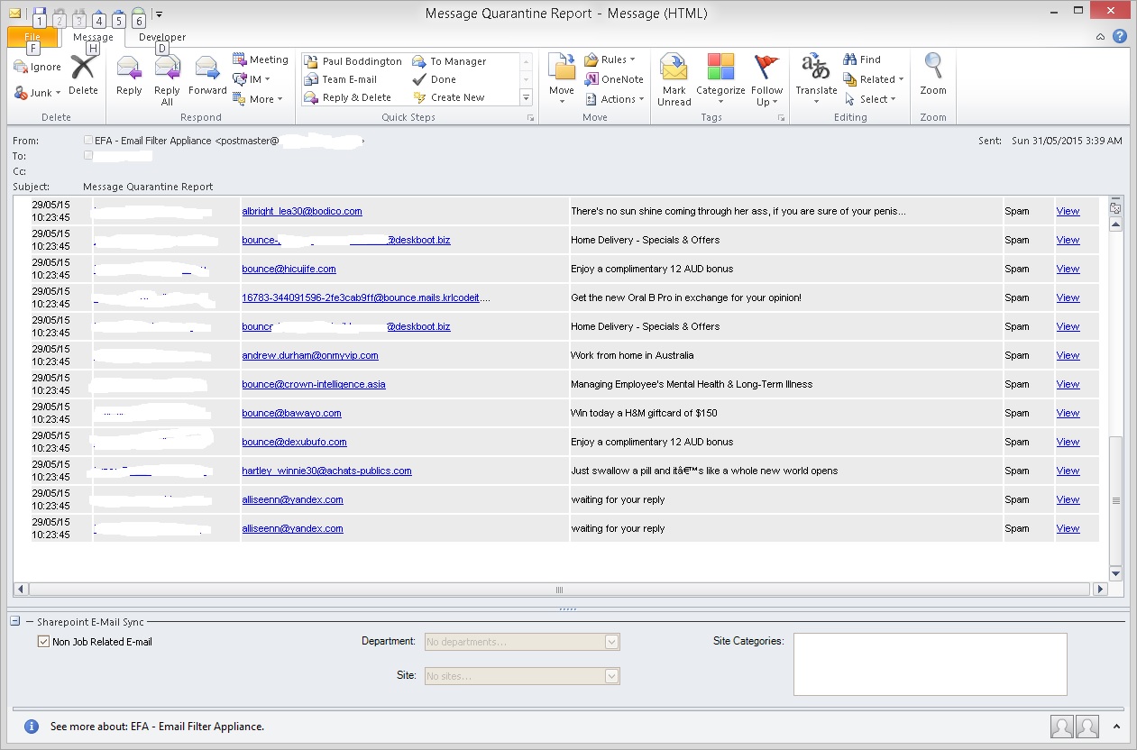

Executed the MySQL command a second time, rebooted and it is working now.... very strange.
An error in the message quarantine report though. When you execute the MySQL script to change host names the "Received time" changes to the date the script was executed.
It looks like the "Received Time" in the spam report is using the MySQL modified date field not an actual received date for the email.
- report.jpg (231.16 KiB) Viewed 13822 times
